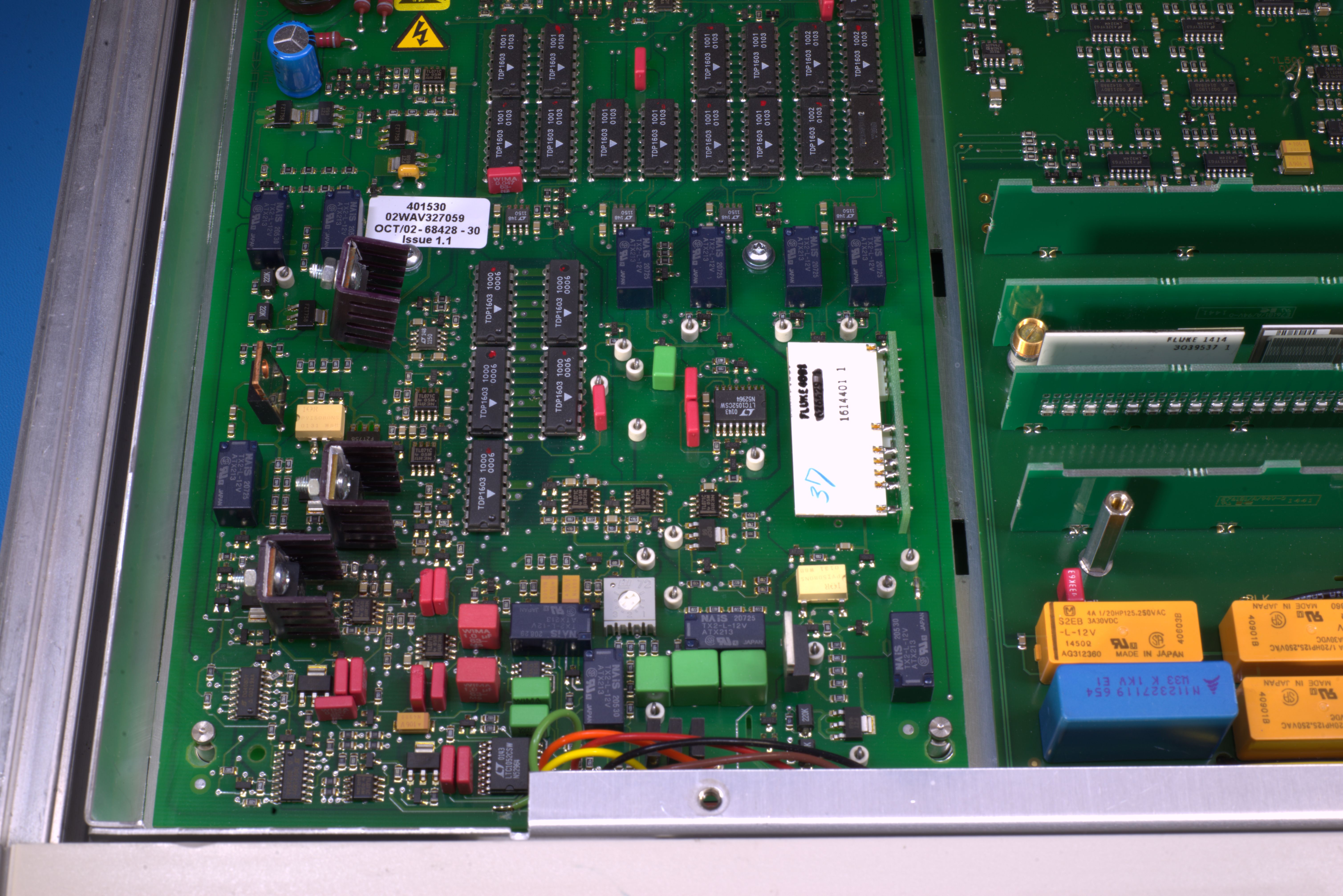

Could be normal. It's been years since I last touched 8508A, as I prefer better 1281 in my lab. :) Also useful to repeat same tests in multiple ranges or at least monitor output current stability of 8508A current source with another DMM.
Here's how older ohms board look like, you can clearly see some capacitors that I've been replacing and bunch of current sources around TDP1603 resistors:
