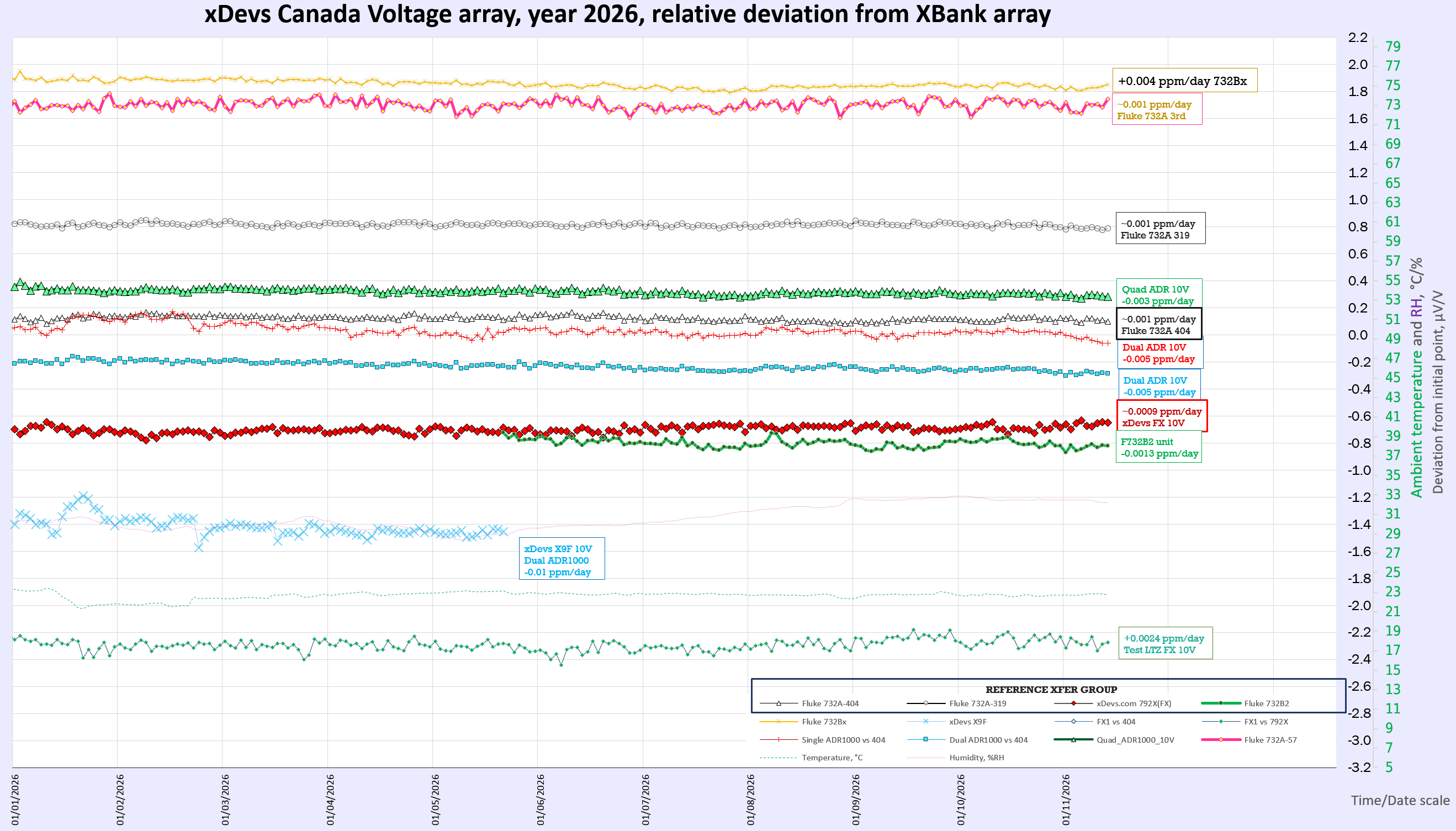

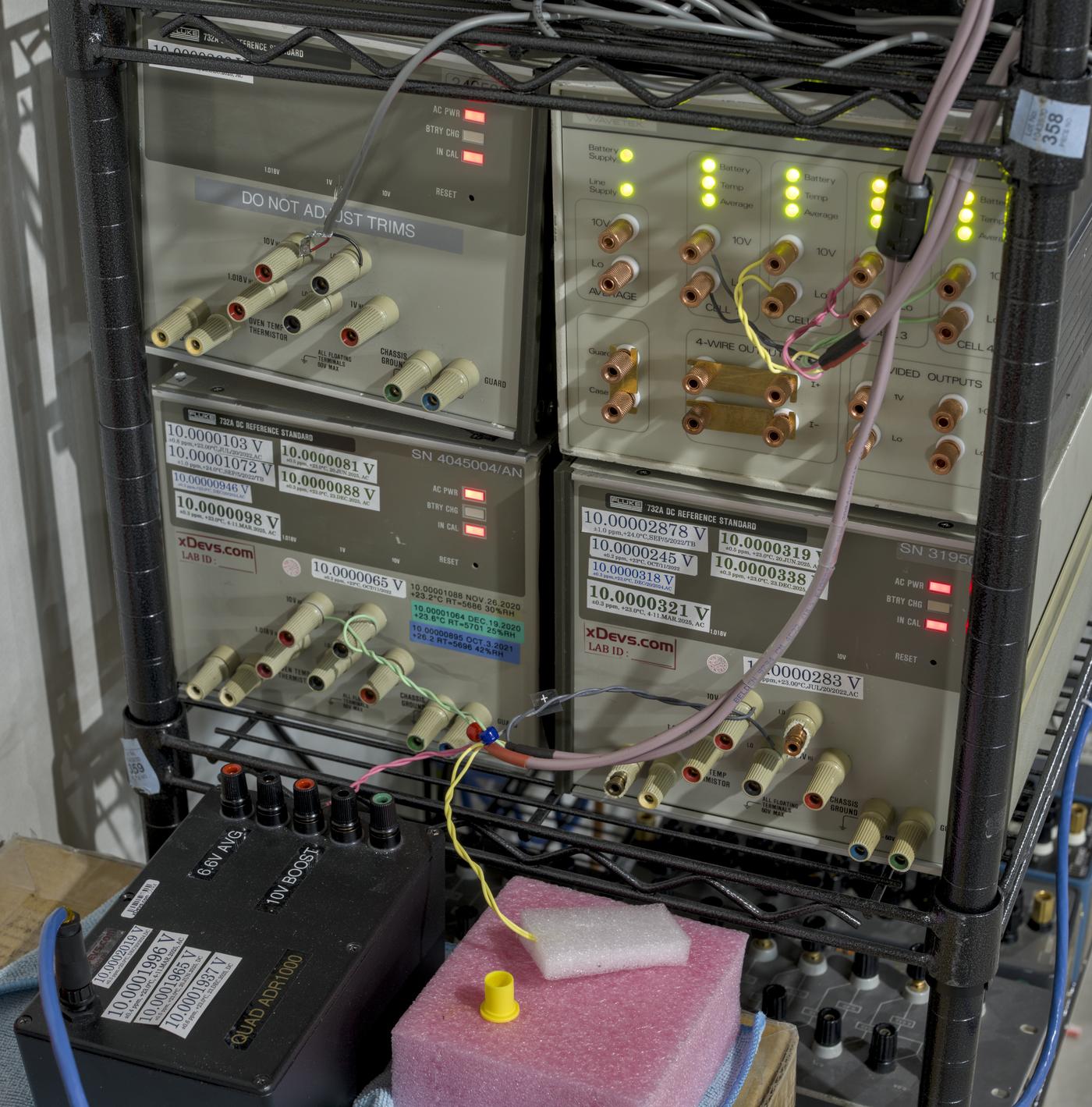

I am massaging data and numbers to present in upcoming article about how I keep "xDevs volt" accurate and continuously monitored and wondering what might be useful and interesting to cover.
Draft article with some data is already in works, you can read it here.

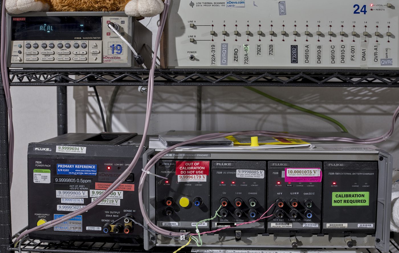

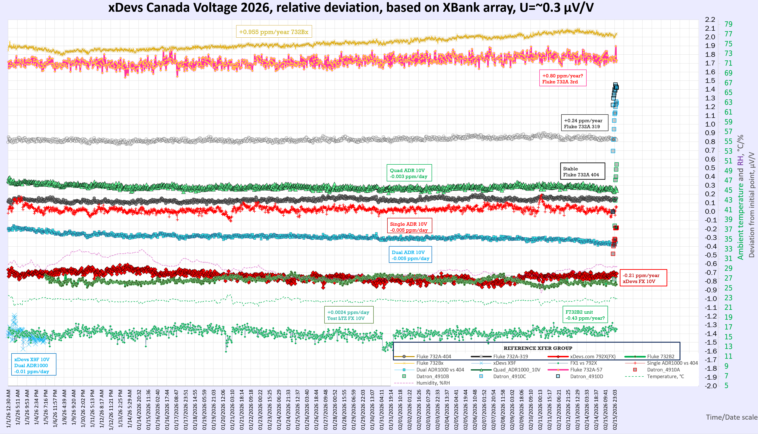

Added new member to the DC Voltage array scanner.
Welcome glorious Datron/Wavetek 4910 quad-LTZ1000 battery-backed reference unit:
Datalogging restarted with 4910 from February 16, 2026.
